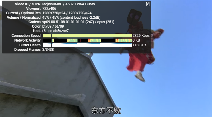

上两张对比图,开启锐速后看720P流畅,足够了,要求不多。
未开启锐速基本2000左右甚至更少:
开启锐速后1W+,稳定在5000-6000:

系统安centos6.4 32位,安锐速就行了,ss用libev版的,正常1080流畅不卡,4k视频2w+,锐速用这串命令即可(我稍微改了改,原命令会出错):
wget --no-check-certificate -O appex.sh https://raw.githubusercontent.com/0oVicero0/serverSpeeder_Install/master/appex.sh && chmod +x appex.sh && bash appex.sh install '2.6.32-431.el6.i686'
锐速参考网页:https://moeclub.org/2017/03/08/14/?v=747
