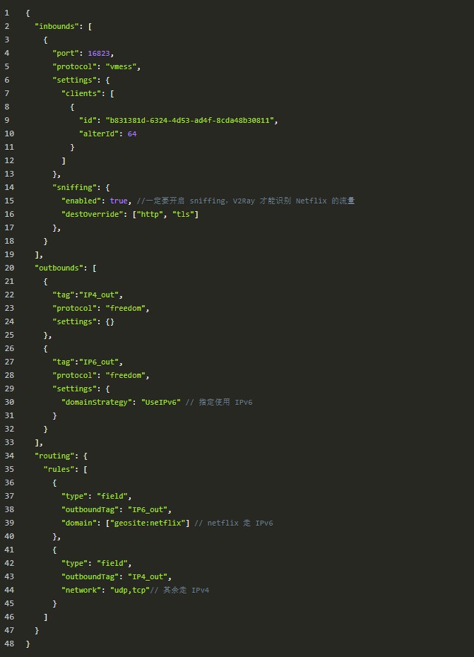

一台vps小鸡,v4不支持netflix,但是v6解锁全局.
https://toutyrater.github.io/app/netflix.html
按照这上面的配置指定 Netflix 的流量使用 IPv6。
只要一打开netflix.com就会报错,下面是error.log
  1. [Info] [1114283875] github.com/v2fly/v2ray-core/v4/app/proxyman/outbound: failed to process outbound traffic > github.com/v2fly/v2ray-core/v4/proxy/freedom: connection ends > context canceled
  2. 2021/03/22 11:10:49 [Info] [4126339752] github.com/v2fly/v2ray-core/v4/app/proxyman/outbound: failed to process outbound traffic > github.com/v2fly/v2ray-core/v4/proxy/freedom: failed to open connection to tcp:**flix.com:443 > github.com/v2fly/v2ray-core/v4/common/retry: [dial tcp [2600:1f14:62a:de82:822d:a423:9e4c:xxxx]:443: connect: network is unreachable dial tcp [2600:1f14:62a:de83:c61a:d6e:18b0:xxxx]:443: connect: network is unreachable dial tcp [2600:1f14:62a:de82:822d:a423:9e4c:xxxx]:443: connect: network is unreachable dial tcp [2600:1f14:62a:de85:d7:e7a1:8f7d:xxxx]:443: connect: network is unreachable] > github.com/v2fly/v2ray-core/v4/common/retry: all retry attempts failed

发表于 2021-3-22 11:26:21 来自手机 | 显示全部楼层
日志不是说了吗?无法连接到ipv6地址,检查你的v6配置吧
发表于 2021-3-22 11:29:44 | 显示全部楼层
你在小鸡里面ping -6 netflix.com 或ping -6 google.com ,怀疑你IPV6根本没通。PING通的状态是这样的:
ping -6 google.com
PING google.com(sfo03s01-in-x0e.1e100.net (2607:f8b0:4005:805::200e)) 56 data bytes
64 bytes from sfo03s01-in-x0e.1e100.net (2607:f8b0:4005:805::200e): icmp_seq=1 ttl=121 time=6.90 ms
64 bytes from sfo03s01-in-x0e.1e100.net (2607:f8b0:4005:805::200e): icmp_seq=2 ttl=121 time=3.23 ms
